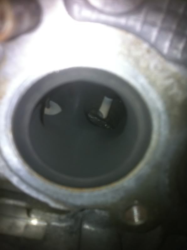

So I had the car towed to Mike's and he pulled off the timing belt to check and see if I skipped timing, or seized a pulley. All my pulleys were fine and it didn't skip any teeth. He pulled the exhaust manifold off to reveal cylinder two and as you can see, clean snapped exhaust valve. Crazy.
Fast forward a bit. Engine was pulled out and I bring it to the machine shop complete. They want to see the engine, which is understandable. Keep in mind this entire time they keep trying to pawn it off as a timing issue, when clearly it's not, and you don't SNAP valves with a timing issue, you BEND valves. Plus, if it was a timing issue, Bren would have picked it up a LONG time ago, and the car would have run like crap.

...and if the timing was off enough to cause this type o damage, there should be evidence of other pistons hitting/bending valves. evidence in cylinder with busted valve would be hard to see, what with the mess of a broken part getting flailed around in there.
