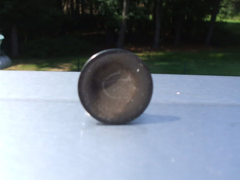

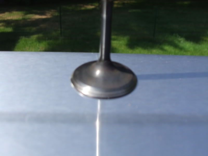

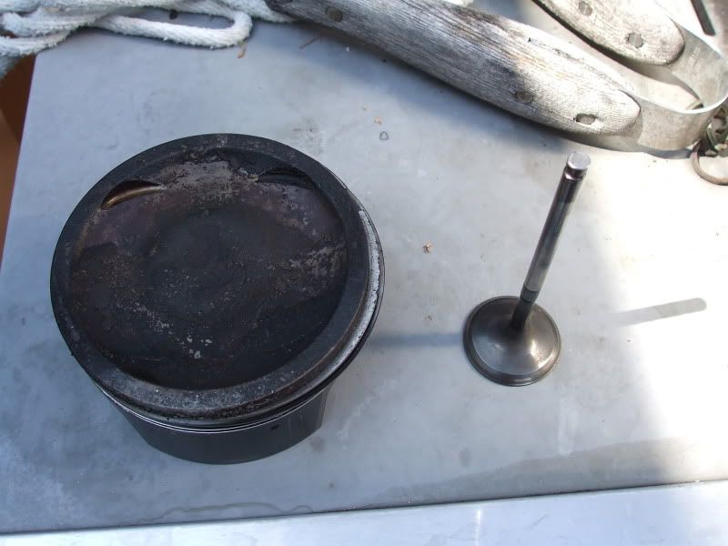

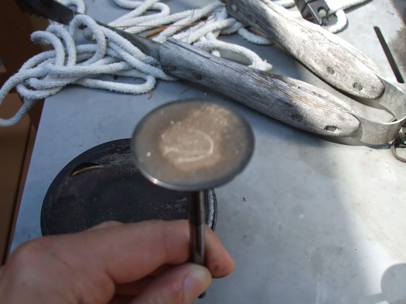

So here's an update. It didn't go over well this morning, first of all. So instead of mentioning and discussing the sole cause of the engine failure, which we know was the snapped exhaust valve, they are now claiming that I had intake valves hitting the pistons. However, as you already know, my timing was fine, and my logs were all good.
Now here's the kicker. I had to ASK to see the heads and valves (weird). When we went to go see them, all 15 other valves were absolutely fine -- no bent valves what so ever, just like we thought. So at this point I ask him how the hell it can be timing if I've got NO bent valves? Something is not adding up. Now at this point he's trying to show me the pistons and how the intake valves were hitting the pistons, but seriously, if they were really making contact, there would have been MUCH more damage to the valves and pistons. I took home a piston and valve, so I'll try and get a pic up.
When I mentioned the exhaust valve snapping, he pretty much acted like he wanted nothing to do with it. He said he had no idea how it happened, and was completely avoiding it it seemed. All he wanted to do was talk about the pistons and timing.
He now wants me to bring in a stock STI piston so they can measure the gapping/pin height on it compared to the Mahle pistons I had in there... whatever this has to do with anything, I don't know.

Take a look at these pictures and give me your thoughts. First thing I'm gonna say is, valve isn't bent.
It all looks fine to me, doesn't look like anything was contacting the piston. Is the end of the valve stem perfectly round? Could be the lighting in the picture messing with me.

where are they saying contact was made? If they suggested that the valve relief was contact, they should not be in business. seriously.
