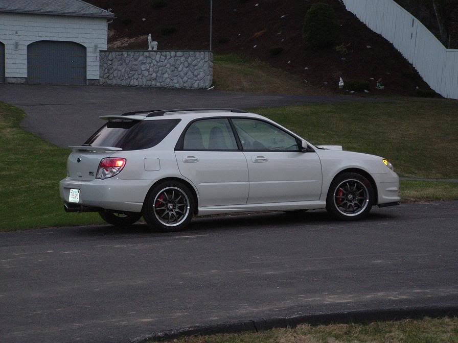

like this

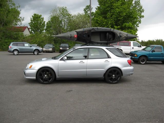

Speaking of showing off... here's my car on the STI specific prodrive springs, I don't seem to have gotten quite the drop that most people get with the WRX versions for some reason or another.... only 17s here though:

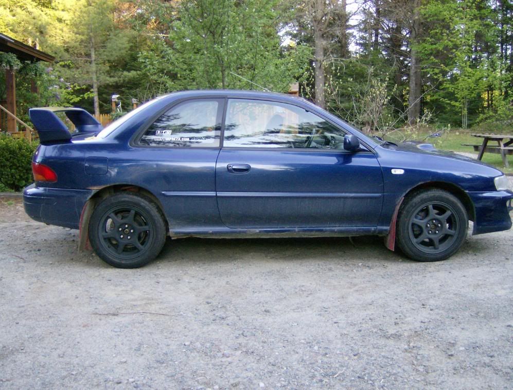

Yeah but with 18's on the car I don't really hammer down bumpy roads so that I don't bend a wheel. Maybe I should just be super cool and put some hydraulics on it. That way I can slam it in the a summer and keep it up in the winter :thumbsup:
