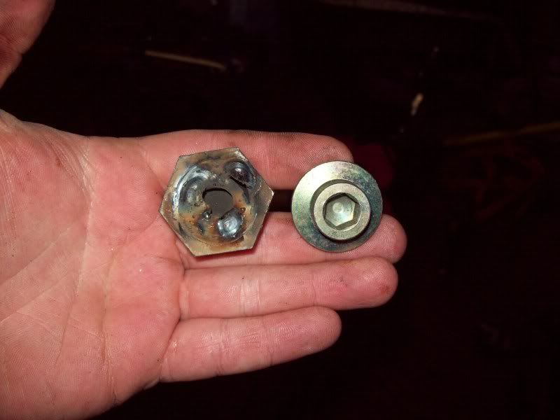

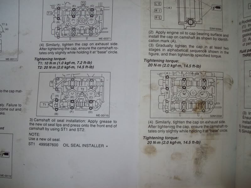

Okay so the oil pump is all sealed up again and put back on. New o-ring and new oil seal. The permatex I used on it was crumbly so I think it had just gotten too old prior to use. Not sure. The passenger side head head came off because one of the cam cap bolt decided it didn't like being torqued 2x the spec and snapped. Hence the oil leak. There is 3 oil galleys under it so it definitely was the leak. I decided to have a machine shop remove it. I could have but the chances of the alum head being damaged instead of the steel bolt waa just too big and I will not have any heli-coils in my engine. So the reason why I torqued them too much is because my subaru factory mechanics manual said to. Joel at evergreen and I were talking and he printed out the new spec sheet and it shows 7 ft/lbs and mine 14 ft/lbs... I will take a pic of them when I am back up there. I was totally not amused.

so the head is NOT ready to go back on. The machine shop actually messed the threads up. I think that he passed it off to the newest guy there, you know, the bottom of the totem pole because it was ''a simple bolt extraction.'' So he wasn't smart enough to check the thread pattern. It looks like someone ran a standard tap down in it or something. Soooooooooo the car will not be put back together today. I will be bringing the head back to them. I was told on the phone that he will do whatever it takes to make it right and fix it right in front of me. He suggested a heli-coil but I hate them so we shall see what's up.

stripped cam pulley bolt:

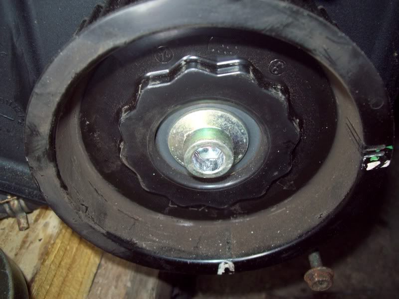

my solution and it's replacement:

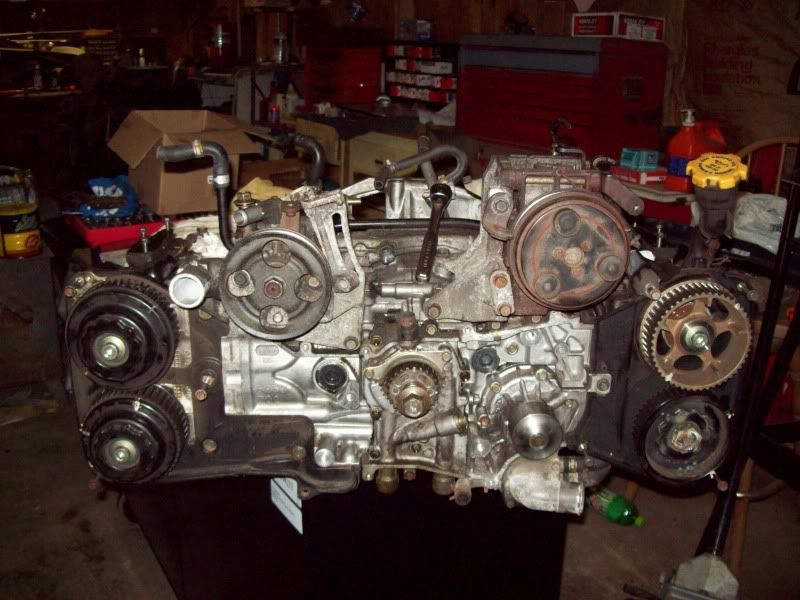

It was starting to look a lot like an engine:
my reason for the messed up bolt: (my original service manual on the right, and the new version printed at evergreen on the left) Note the torque specs
