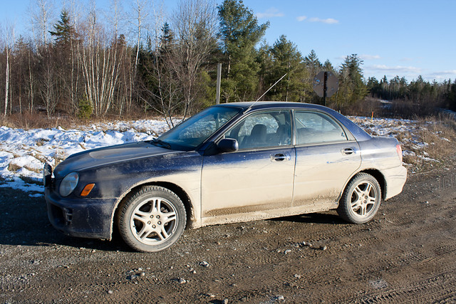

So I have test driven tons of cars and hated all of them. I love my RS but it's a boy racer. While I love rolling into work with the loud exhaust rumbling through the parking garage covered in mud with the light bar looking awesome, it was time to grow up. The impreza has served its purpose.
