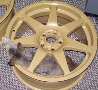

I love how nobody cares about the car, but the cat, now there's some big news in dan's thread.
I tear the driveline out of a car and no one cars. I post a cat and that's all people see.
I should paint some rims and put some hella horns on my car then everyone would go bananas....
