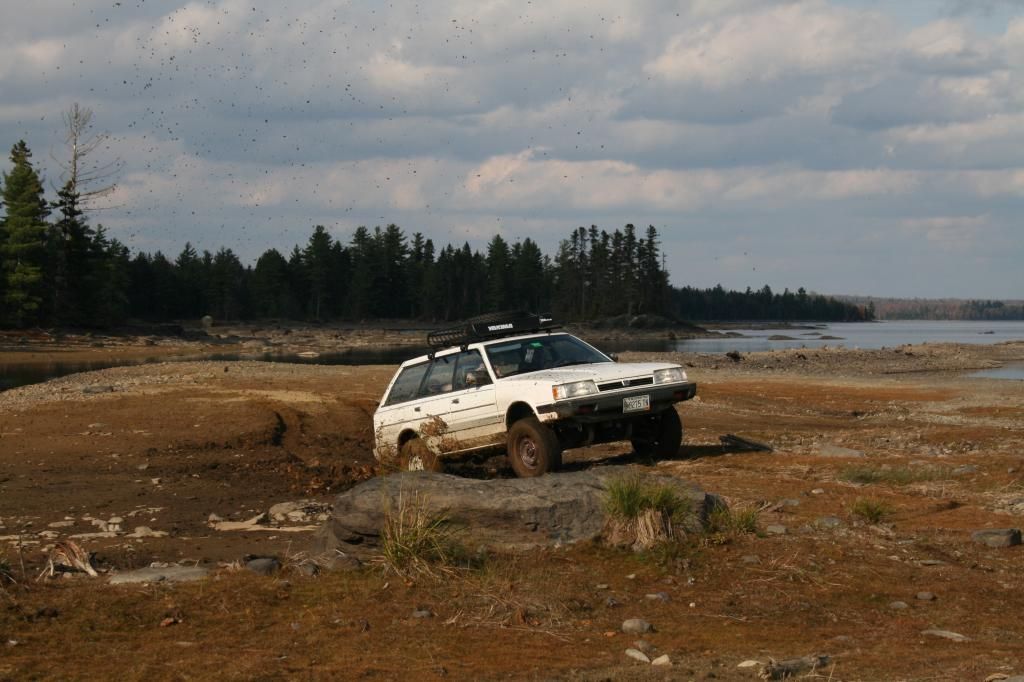

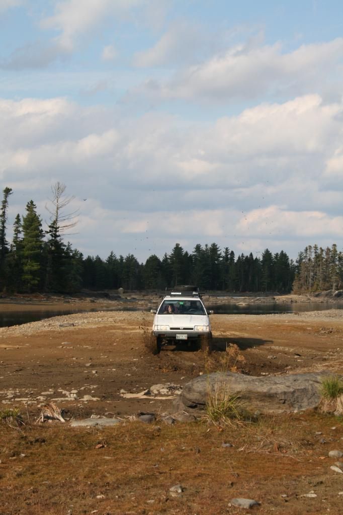

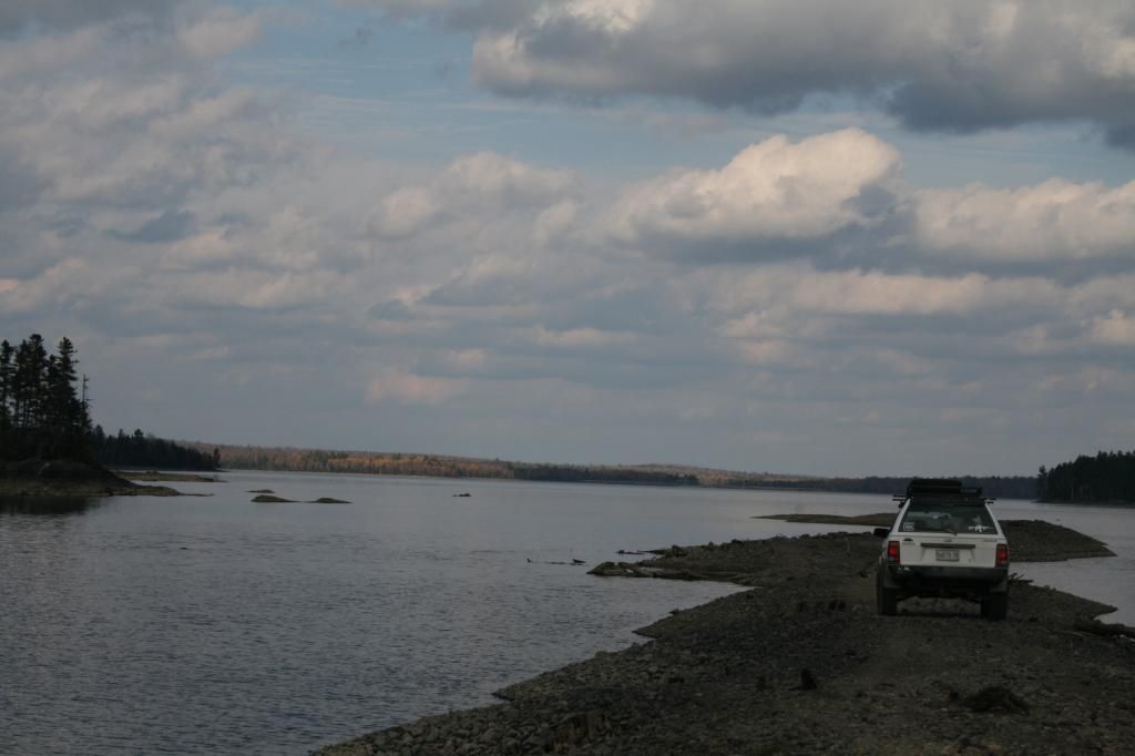

Have a new mod planned! I think it'll work, and look pretty sweet!
Also should have some more pics up after my sister brings her flash drive over.
