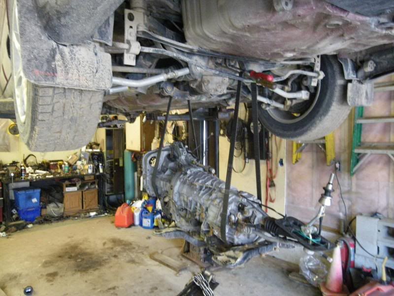

if garrett would bring back my f'ing tie downs i wouldnt have to use timing belts to lift transmissions lol
