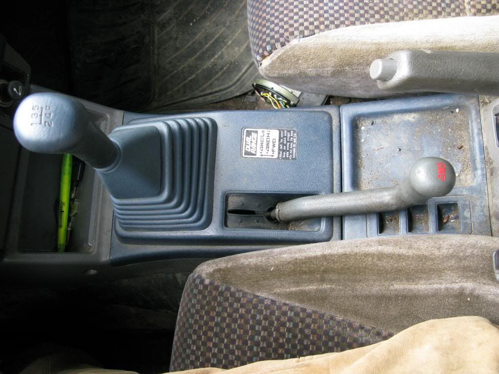

What exactly is the difference between "lo" and "high" range modes? I know that's what makes it a dual-range tranny, but I wasn't able to figure out what the little dial changes.
There is a lever by the shifter for switching between FWD, 4high, and 4 low. FWD and 4high are the same, except 4high locks the center diff to transfer power to the rear diff. And since it is locked, no running 4wd on pavement!
4low is the same as 4high except that it reduces the output to the diffs by 1.6. So for the same revs you get less wheel speed. Good for crawling over stuff, getting un-stuck, etc.

Ah, so its all in the diffs. Thanks for clearing that up.
It's all in the transmission, actually. Nothing changes in the diffs. The only diff that changes is the center diff, it is either locked (4wd) or opened (fwd).
For low range I believe there is a gear set on the input shaft that reduces the speed coming from the engine. Thus reducing the revs to the whole drivetrain giving you more engine revs per wheel speed.

It isn't 5 extra gears. It is 2 gears. Like a pre-transmission if you want to think of it like that.

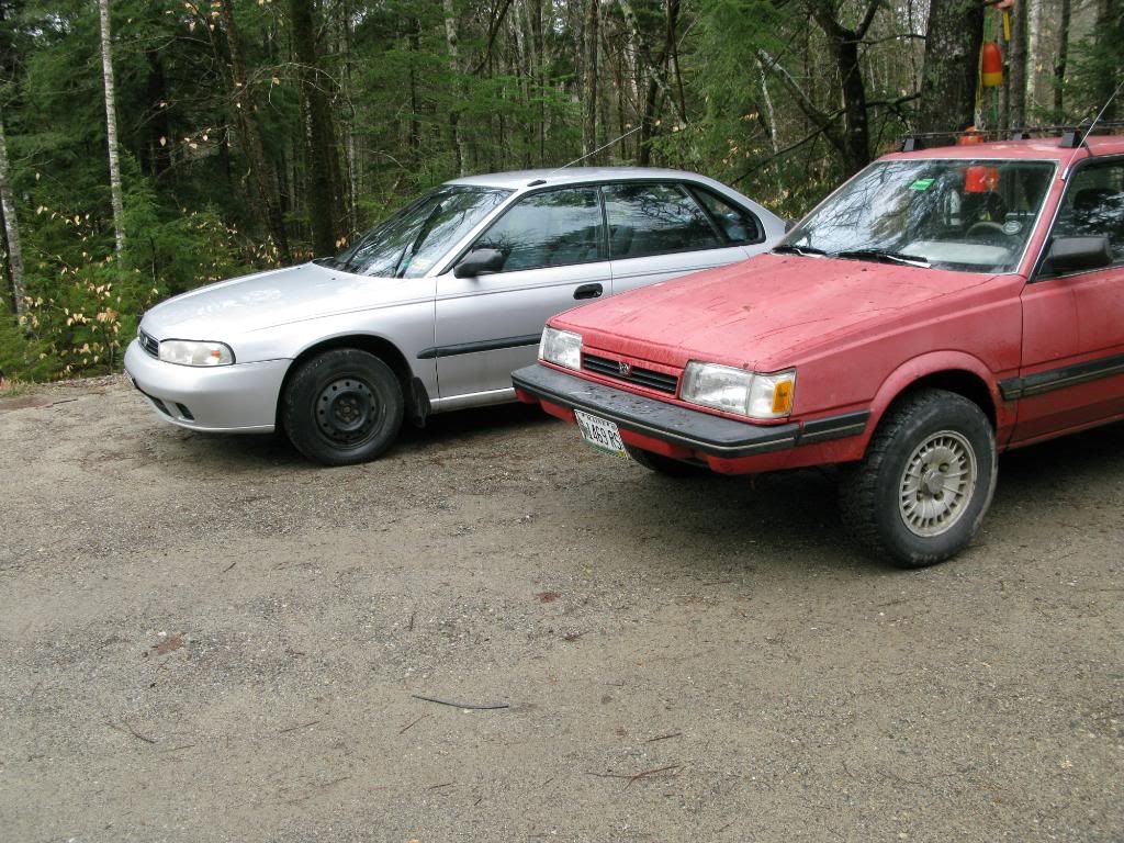

Had to run some errands this morning, so I took some pics and vids. There'll be more this afternoon!

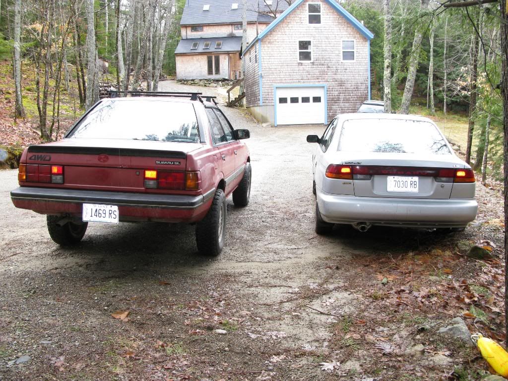

Both my cars:
This one is for you Nate:

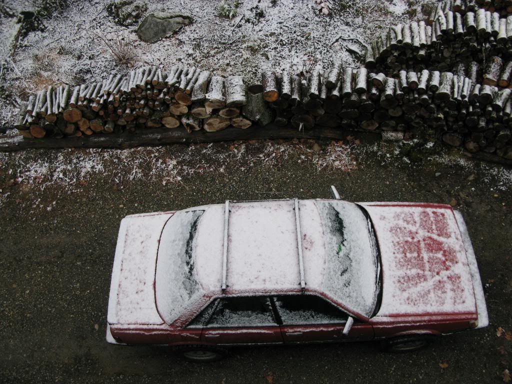

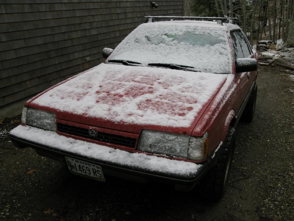

Woke up to a little snow this morning!
