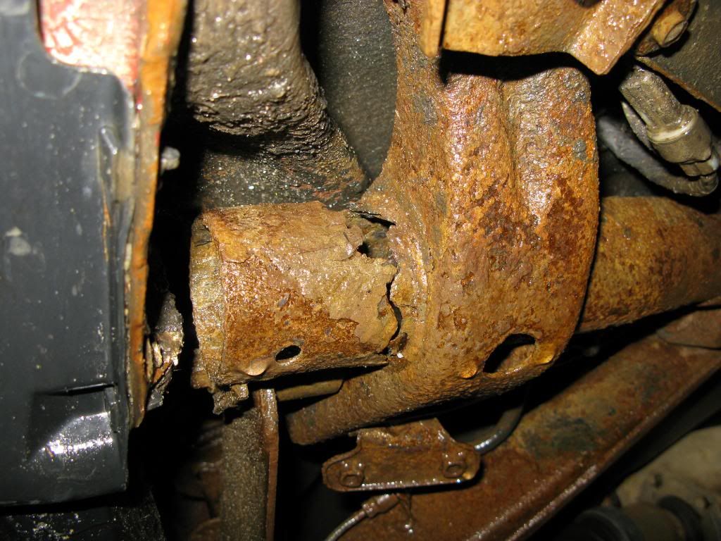

Sooo, I failed inspection with flying colours.
* They don't like the wheels sticking beyond the fenders, so I need to make flares or find different wheels for inspection. So I'll find some rubber and make some fender flares or something. (should be easy...)
* Don't like the rust hole into the trunk, BONDO! (Should be easy too...)
* He didn't like the front sway bar being there and not being connected. But said if I removed it that would be fine. So that's coming out. DONE!
* The brake pedal is to low, which I was afraid it would fail for. But they just need to be bled. (Should have been easy, major fiasco)
* he also really really didn't like the reverse light situation, but since they work he couldn't add it to the list
So those are all things I can probably do in a day no prob, but this last one, I have no idea what I'm going to do about it
the slip says "right rear reinforcement bracket for torque arm." It's rusted out and isn't going to pass until I get it welded or replace it. Both of which are going to be a pain/expensive. So it looks like the GL is off the road until I get some money for that. I'll get a pic so you can all see what I mean.
I'm really not sure what I'm going to do about that, but nobody is going to pass it until something has been done.

Tyler
I'm not sure about that reinforcement ... wrap it in a sheet of metal and weld that on?
