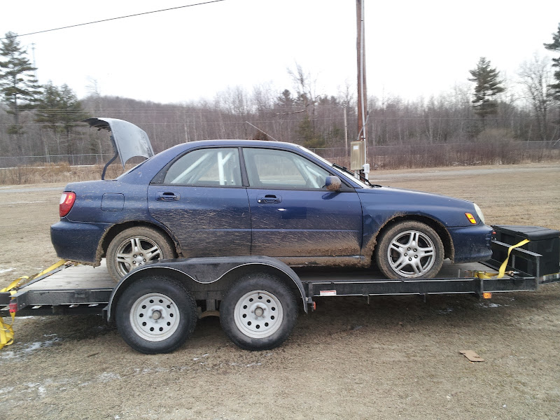

Car unloaded.

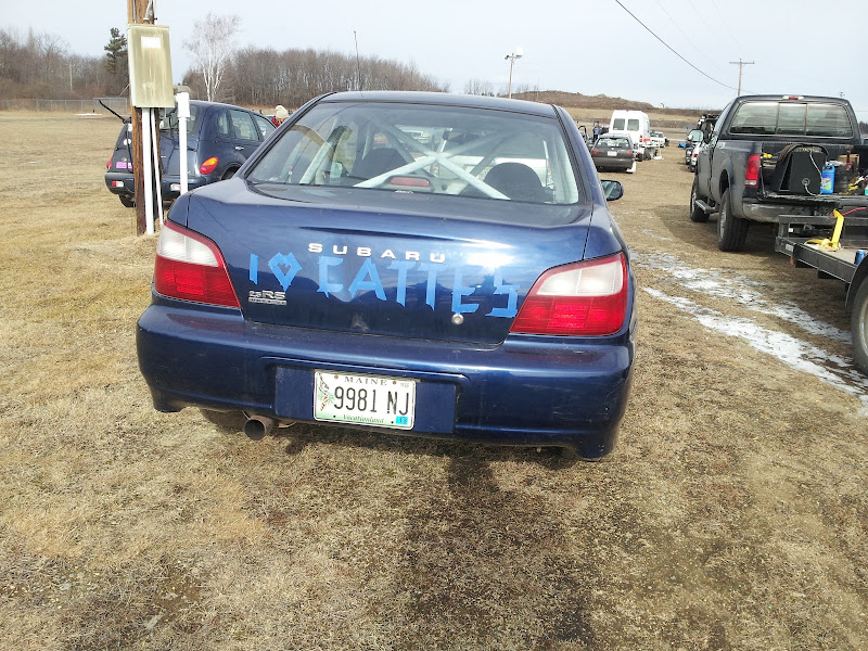

Mid day after getting my ass kicked, team #NEAI decided my car needed to be decorated:

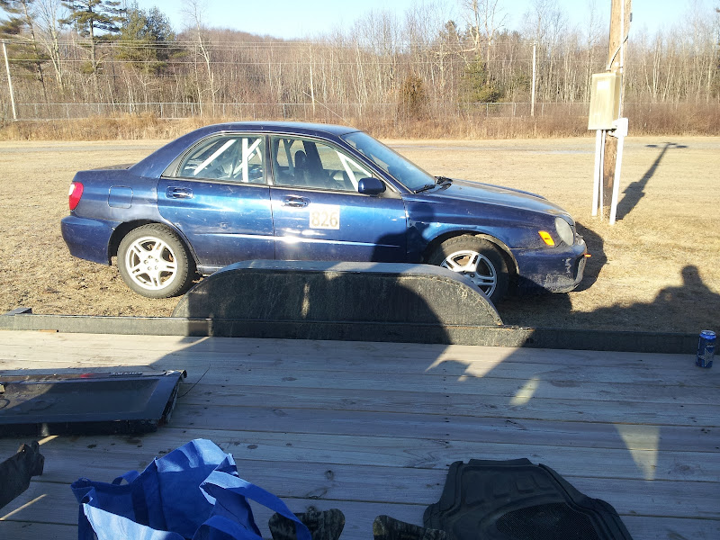

Finished out the day lookin' dirty:

So I got my ass kicked all day. Came in dead last. Between the bald tires from 2004 and the cookieed up rear suspension the car just had NO traction on frozen iced over grass.
