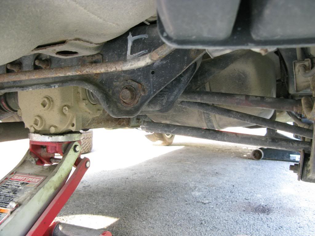

I also broke a lateral link......
Scary ass drive home from Bangor. Welded it back together last Sunday. It's "good enough", but Gabe (Trainable) hooked me up with his WRX lateral links which I'll be throwing on tomorrow.

Yeah, I lucked out. Rear link was easy to hold in place with some JB weld over night and some zip ties. Got it home and welded it.
Turns out my father went on a business trip, so instead of driving the RS I drove his commuter mustang all week.
So a fresh set of 06 wrx links are going in tomorrow, and the RS links will get added into the racing spare parts collection. I'll eventually upgrade or fab my own stronger links, but for now it's "good enough".
