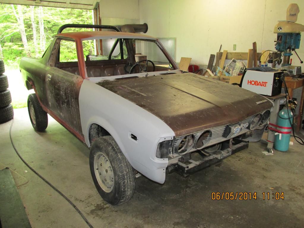

And this is a sneak peak at my newest project I acquired.
IBratmanI
Can I have the Brat?
Lol. Sorry but no. Should be pretty sweet when it's back together. It started life with a 1.6 and a single range 4spd. It'll now have a 1.8 and dual range 4spd. And quite a few other modifications as well. And it's pretty solid as well.

How high is that lifted already?  Id love to find another one, we used to beat the snot out of those things in high school.  Wish we hadn't now though...  I saw one on CL for 3600 in MA, supposed to be really nice..
IBratmanI
Well it has newer ea81 Gen 2 crossmembers and suspension modified to fit under it, and has a couple inches of lift on top of that. So it's at least a few inches higher than stock. This one will be more of a poser. It'll have a little bit of the off road look and capability, but won't be beaten off road. It's definitely not perfect, but it's way too solid an rare to beat to death. All old subarus are hard to find, especially in decent shape. Especially on this side of the country.
