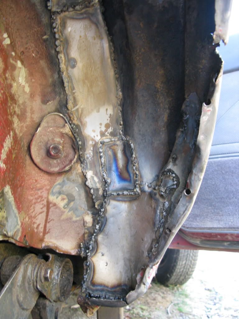

I re-constructed the rear belt mount area. It was a big gaping hole. Made most of a new rear fender liner. The place where the back door closed and sealed was gone. So I re-fabricated that. That's the only spot I ground, because it has to seal. And a lot of that was thin there, so it'll need just a bit of filer to file in the holes.

I took one picture. This is 3/4 done, there's one more piece of the inner fender I welded in. But I didn't take a picture. Because I'm bad at pictures.
My welds suck. If someone wants to buy me a welder with a lower power setting, and gas. I'd love you forever.
I did a whole new inner fender bit in the top of the wheel well. Which was a major pain in the butt. I had to lay down and weld over my head. Lots of wet rags on the rubber fuel fill pipe!!

Overhead welding SUCKS. I had to do it on the RS quarter rebuild. At this point it might be worthwhile to cut out ANY rear quarter you can find and hammer it into shape so you have to spend less time hammering a curve out of flat metal?
