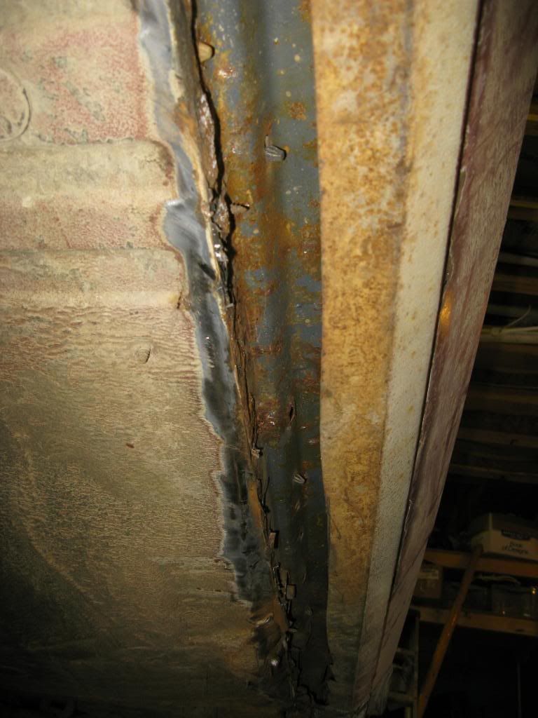

PICTURES! Driver's side rocker is hopelessly rusty.

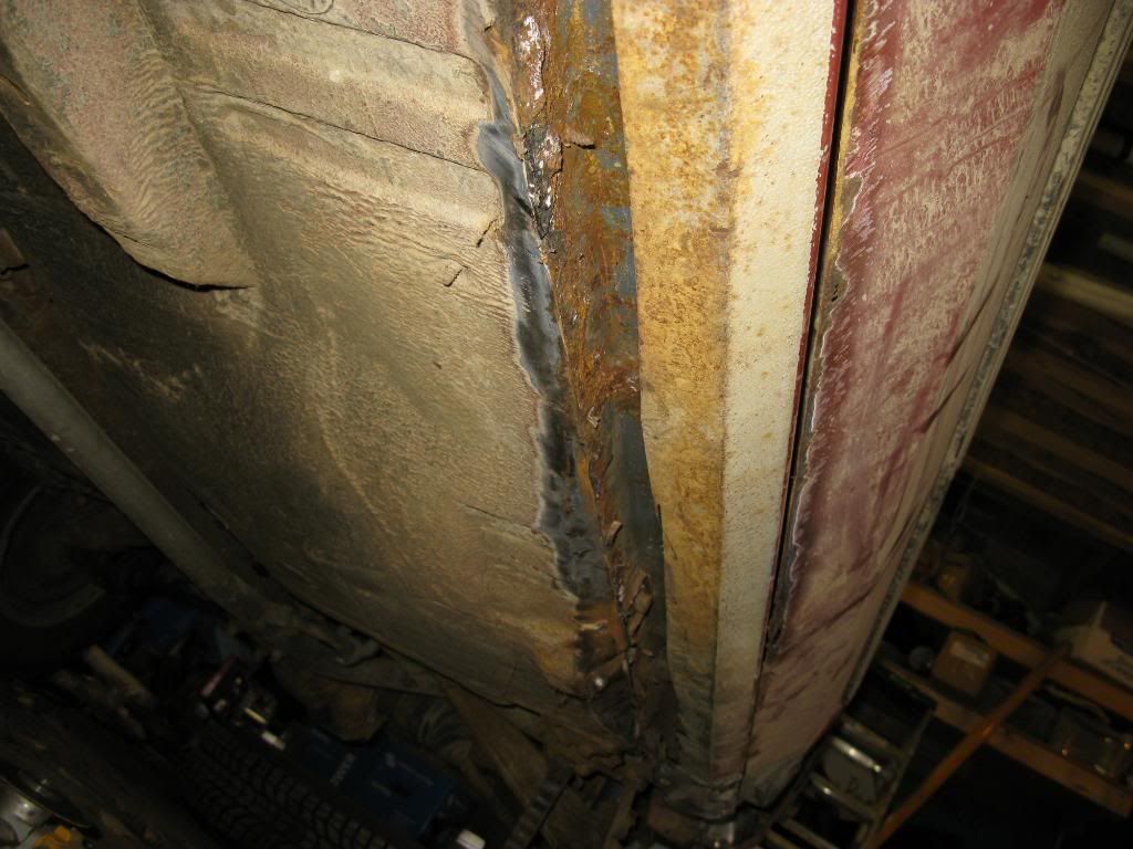

So to get rid of the rust, most of the rocker went away.
And this is where it all ended up...

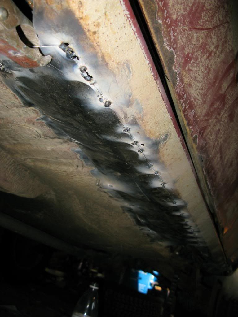

Then I tacked in a new piece. Unfortunately the front bit was a bit thin where I tacked it. So now there's another plate up there, and it's in nice and solidly.

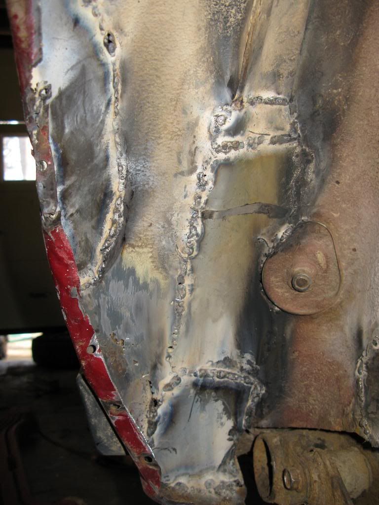

Rear quarter fixed. No more stuff falling out of the trunk or getting wet.
The front bit of the rear fender well. Behind the back seat. No more moldy nasty back seat.
I didn't get a picture of the top and back of the wheel well. It's hard to get a good picture, just like it's a hard place to weld.
Oh, and... WELDING UPSIDE DOWN SUCKS.

Unlike him though, I cut all the rust out of my rockers before I weld in new metal.
Not pictured are the supports I welded in under the new metal in the rockers. So it should support the weight of the car at any point. At least, that's the idea. I'll play with the jack when I get it done.

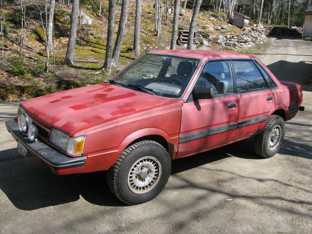

The front fenders look so nice with just fresh primer, I think once it warms up I'm going to do the whole car flat red with a black two tone.
