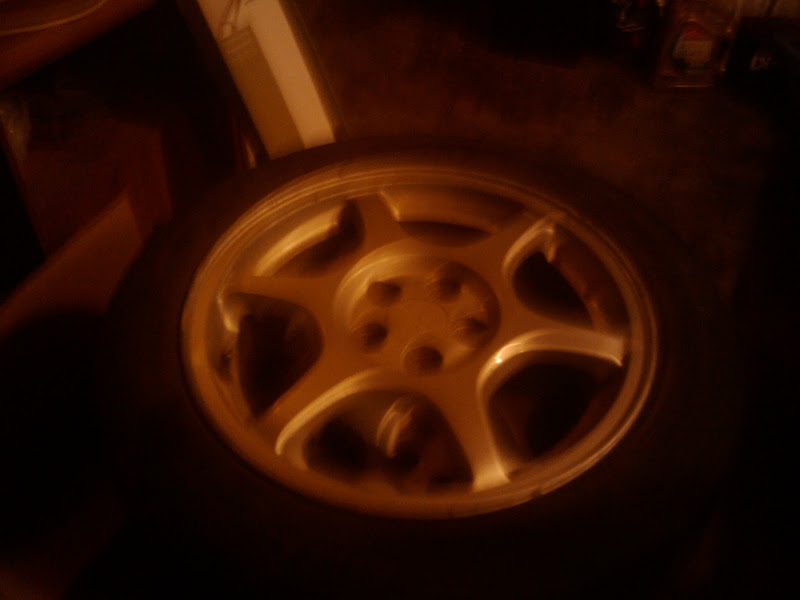

While the Jeep is solid, reliable, and a good rig. I miss my rally slut.

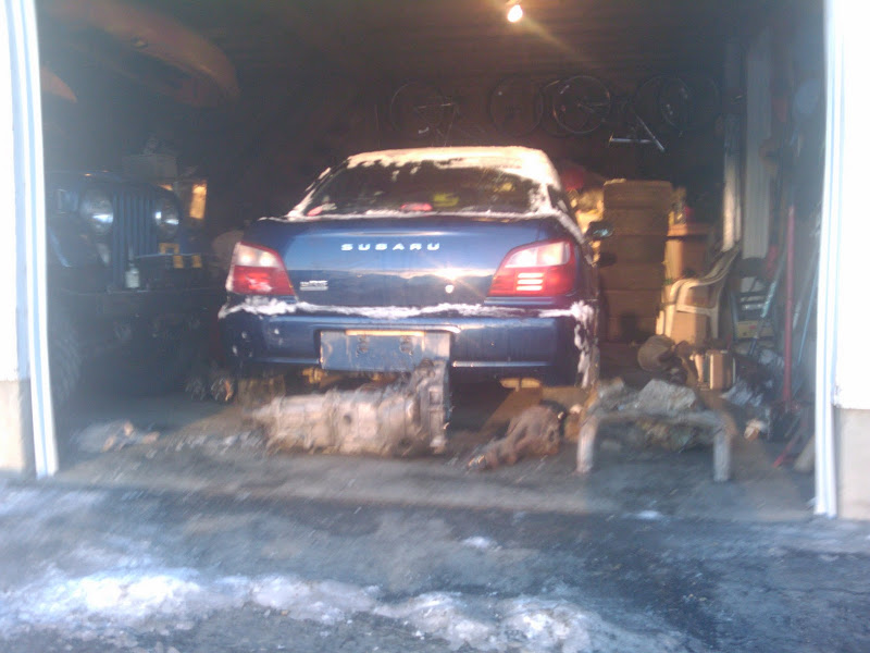

This weekend I'll be organizing the garage, hopefully making room in one of the bays to park the RS. We've got two race cars and a project CJ5, a ton of parts, over 30 tires, plus my motorcycle and other toys; and 4 tons of pellets for the stove... A two bay garage isn't cutting it.
Hopefully I can get POOP sorted out Sunday and next weekend get the RS dug out and on jack stands so I can start chipping away at the drivetrain swap.

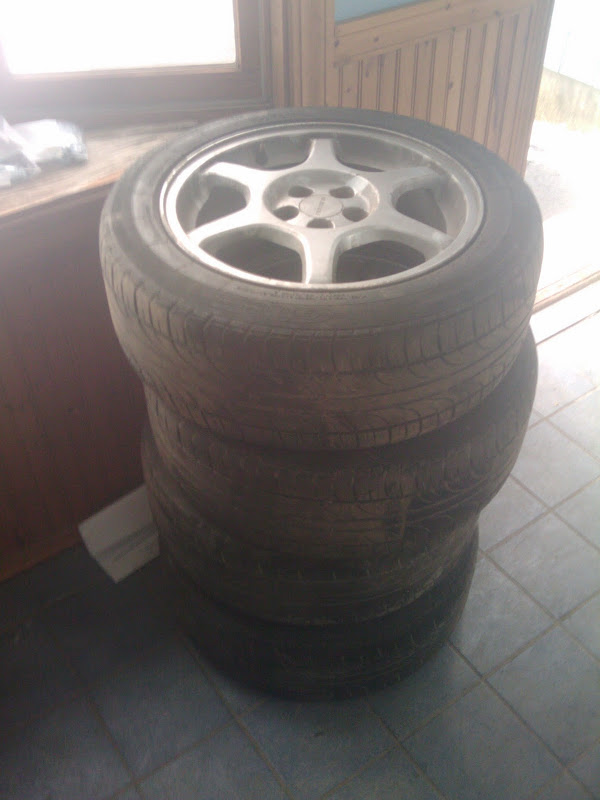

6 spokes I had to move into the breezeway while reorganizing the garage.
The mustang was blocking in the RS. The Jeep took care of that problem.
KrazyKarpenter dug around the RS and stang. We got the hitch on the Jeep and after he left I pulled out the stang and the RS.
Where I left off. In the garage and all the parts organized. I wanted to get the diff/axles swapped today, but the Jeep hitch ended up taking way too long since it's a Maine vehicle.
I plan to plug away at it more tomorrow, but I've got to get the plow Jeep fixed first.

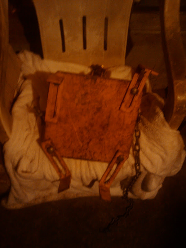

Stop by my friends shop and grabbed the head of his transmission jack plus clutch alignment tools.
The whole transmission jack is too tall to get under the RS when it's just on jack stands... so the idea is you take the head off the trans jack, put in an impact socket into the receiver, then put the trans jack head + impact socket into a regular floor jack. Allows for easy reinstall of the transmission rather then having to bench press it.
